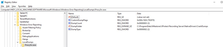

Strange. Please check this Registry entry. If you have it check the folder. If you do not have it try to create it.
BTW. What version of XProtect are you using?
The registry key above does exist and has the same values as your screenshot.
I’m running XProtect Corporate 2021 R2.
