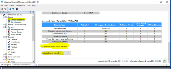

About the license, you need to activate your license in Management Client. Start Management Client – see License Information and Activate the license in the picture below.

Looks like it was the fact that licenses weren’t being auto-applied, and I guess I had too many “cameras” in StableFPS (wasn’t clear to me).
