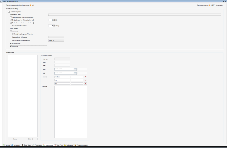

  1. make sure your management client is a configured correctly and investigations is enabled try to export from a official client Mobile/Web and see if it works if not this is likely the case or a license issue.

Thanks for the reply and I’ll have enabled the above configuration and it started working, but unfortunately I’m getting that error time to time.

  • Session expired before the export is intiatied or while it’s exporting try increase the timeout period in the management client and see if the issue persists
I have updated the SDK to match the version and also increase the timeout period in the management client.
