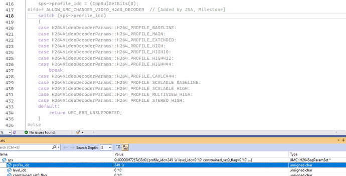

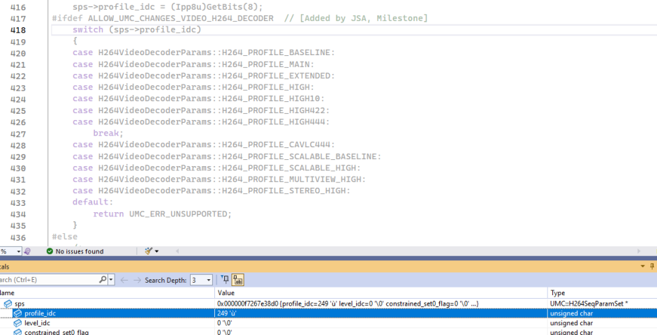

I debugged the decoder, and now this is going to be a bit technical:
Any h264 video begins with a data structure that contains a byte (profile_idc) that indicates the decoding standard that the video adheres to, and for the video in question that number is 249:
Now, 249 is not a value that we recognize as a valid profile ID, so the decoder returns UMC_ERR_UNSUPPORTED. I looked in the specs for h264 to see if it is a new value that has been introduced since our decoder was implemented, and as far as I can tell it is not.
That leads us to the question of why the Intel and Nvidia hardware decoders will decode the video, and there we don’t have the luxury to debug right in to the source code, but one could guess that they are simply less strict about validating the profile_idc parameter, and make an assumption about what 249 means, which happens to be correct.

I’m only referring to the official specifications. It’s an extremely dry document that defines the specs with almost mathematical precision, and it doesn’t have any examples (https://www.itu.int/rec/T-REC-H.264-202408-I/en). Details about video decoding standards is not exactly a topic that is well covered with examples and tutorials online. However, paragraph 7.4.2.1.1 on page 76 gives some insight into how the profile_idc parameter is constructed. Notice that the last two bits are reserved zero bits, and the value 249 that we got from the attached file is an odd number, so one of the mandatory zero bits is actually set!

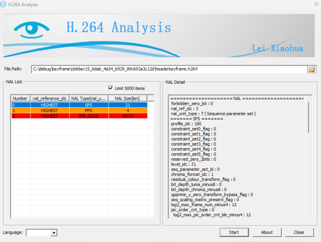

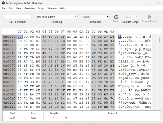

This is an example of what I get for the first keyframe sent to XProtect. It seems correct on my end, making me thing maybe I should have another encapsulation rather than pure H264 NAL units? I have compared this to an ffmpeg remux to direct H264 as well.
The below is sent as a single entry into the byte array. I have tried many things, but it seems prepending the SPS and PPS to keyframes works better to decode with acceleration, maybe giving a hint as to what I’m doing wrong. I am working in the dark as I have no documentation regarding what XProtect expects with the H264 codec, which is why I’m asking.
As above, it seems I’m passing idc_profile 100 to it, which should be supported, so I’m assuming my headers are messed up.
An example hex dump of what I’m passing into XProtect’s byte array frame response for a keyframe’s start
