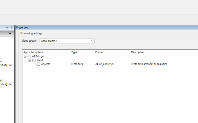

We are working with AI Bridge and custom IVA applications. After a Milestone Management Server reboot, all services recover correctly:
  • AI Bridge restarts normally.
  • IVA applications re-register successfully.
  • Metadata topics themselves are still present in the system.
However, the subscription from each video stream to the processing server (the binding of a stream → app → metadata topic) is lost. In other words, the topics exist, but the per-stream subscriptions to the app do not survive a reboot. We need to go back into Management Client and re-apply the processing settings each time.

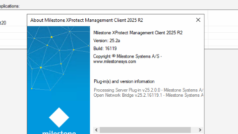

Can you let us know which version of:
  • AI Bridge
  • Processing Server Admin plugin
Are you using ?
