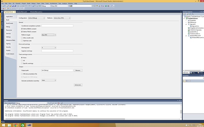

Using VS2010 Ultimate.
I’ve attached my configuration - I only opened solution and rebuild it.
Could you try this on another PC? My only suspicion is the VS setup but nothing concrete..
