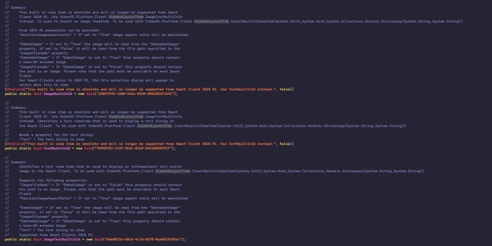

This is found within the ViewAndLayoutItem class of the Milestone SDK. You can access it by pressing F12 on the declaration or by hovering over ViewAndLayoutItem.TextBuiltInId.
imageWhen I hover, I can see that it gives the correct description, but when I go to the declaration, the obsolete description is different.image
Hi @Bo Ellegård Andersen (Milestone Systems)​ ,
Let me know if I was clear enough for you.
I have reached the realization that the “documentation” part is correct, but the Obsolete attribute caries the wrong information. The way you document your observation is crystal clear, thank you for the effort.
I will make sure this is corrected for future releases of the MIP Library. It will not be in 25.3 as it is closed for new additions, being tested and finalized for release, but I also hope you do not see this as super urgent to get fixed fast.
