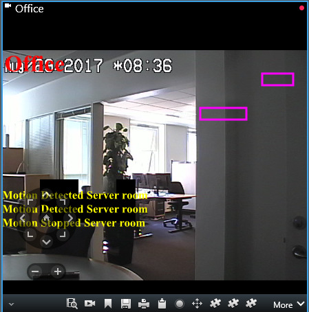

I would like the puzzle icon in the SCToolbarPlugin sample wit a built-in camera view item where in I want to build the existing functionality like below
Excellent, this is what the SCToolbarPlugin sample does. The sample does this in the ShowCameraNameViewItemToolbarPluginInstance class, many of the other classes might not be needed. You can copy the class and code to your plugin.
Not only puzzle icon I want to add all the button and its functionality which is shown in the toolbar as shown in the above image

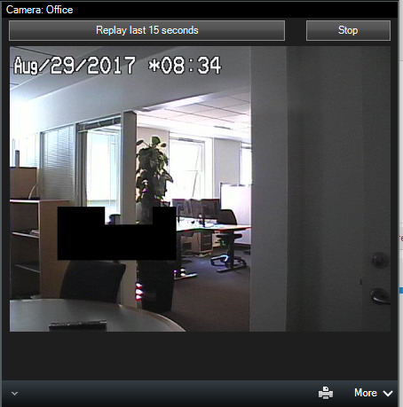

A built-in camera view item:
A MIP plugin view item: (VideoReplay sample)
It is unfortunately so that when you are using your own MIP plugin view item you cannot get the icons that automatically present themselves when using the built-in camera view item.
