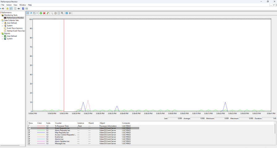

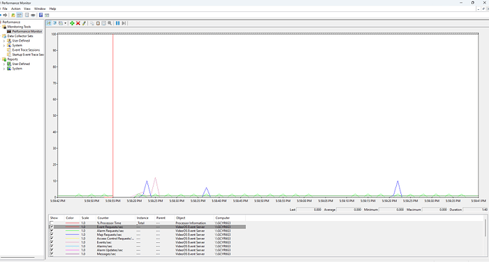

  3. I have checked the performance counters and logs but not found anything.
