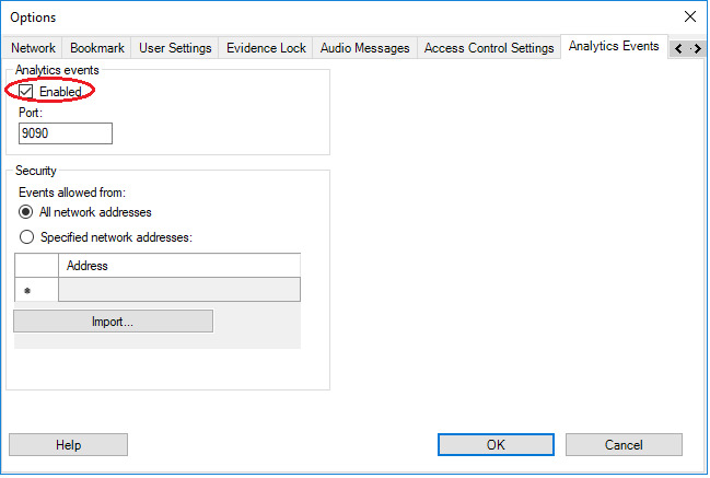

Thank you for your response, I have been going through the documentation and sample solutions, and everything makes sense but the SOAP port (9090) to send the XML document containing the analytics event data is not open. I am on the corporate version of Milestone. Is this something that I need to configure when installing milestone or later? And does the Event Proxy service have anything to do with getting port 9090 open?

I am wondering if you are missing settings on Management Client, start Management Client – tools – Options – Analytics Event tab.
