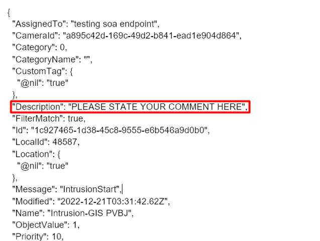

Trying to update Alarm "Description" field through SOAP but failed.
Hi,
We are working on a protocol integration to update the Alarm state and comment. But seen like we cant update the “Description” field.
May I know how to update the above field?

You cannot change the description on an alarm. If you try using the Smart Client Alarm Manager, you will observe the same behavior.
With the UpdateAlarm method there are a number of fields you can update. You can see which here on the documentation to the proxy class in MIP SDK.
https://doc.developer.milestonesys.com/html/index.html?base=miphelp/class_alarm_command_client.html&tree=tree_search.html?search=updatealarm
See UpdateAlarm and UpdateAlarmValues.
Maybe the text by UpdateAlarm will serve your purpose.
The description fields are in most case setup in the AlarmDefinition. AlarmDefinition can be created or changed by using Management Client or by using the configuration API or rest API. The moment an alarm is triggered the Description/instructions is fixed and cannot be changed later.
