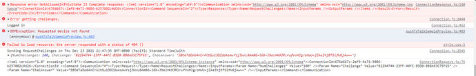

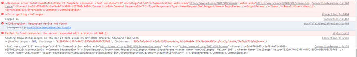

getting error message
error = DOMException: Requested device not found
Hello Divyakumar and Happy New Year.
This error means that there are no web cam or microphone on the Windows Server 2016. Is that correct? If yes you need to have microphone in order to use the push to talk functionality.
