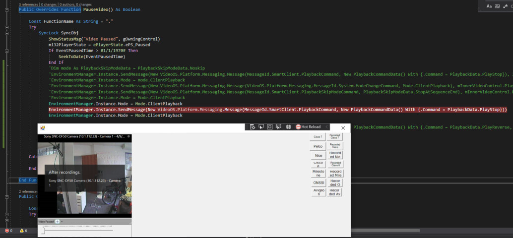

I have implemented pause like this way, but it always go to after recording, not sure if I am not having right timing for the pause video to work on
I have no idea what your if statement does. If you just do the PlayStop and nothing else doesn’t that playback stop immediately?
I don’t understand why you have the Mode commands, if you have somewhere else that calls Mode.ClientLive so that the mode is changed at the wrong time it could affect the playback experience. Can’t you leave out the Mode.ClientPlayback here?

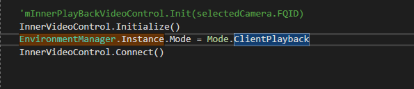

I have been seeing these two statement everywhere to control the video in the sample codes, (here, VideoViewer2Playback), like to be in playback mode then control the video secondly
Which I kind of changed in vb.net

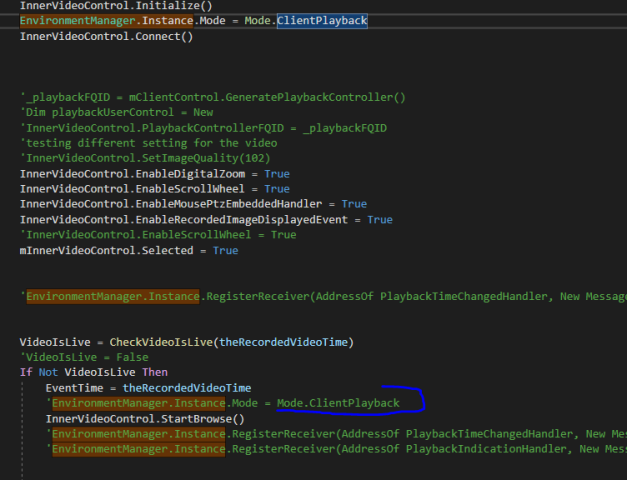

I tried few places
before connecting to the camera
After connecting also
so only place it didn’t go to after recording message was in near the playstop commands, etc
I am able to get the recording working with clientPlayback mode but it goes like after recording (seems like getting the current UTC time)

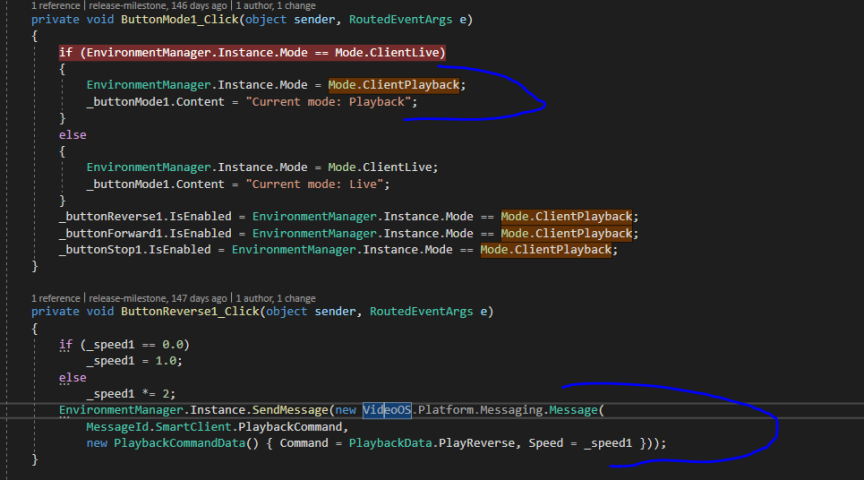

I am worrying that you should only change mode when you need to switch from live to playback or the other way. In the sample there is a button to change mode..

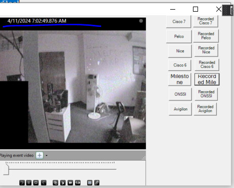

VideoOS.Platform.Client.ImageViewerControl.EnableVisibleTimeStamp is enabling time to show but I wonder how can I know what timezone, or get the time as return value
for example, how can I get this value
If you backtrack a little I wrote.. “In the sample the PlaybackTimeChangedHandler is used to display the time being played back”. This is how you can get the time. I believe you get the time always in UTC, then you can convert to local time.
Yep this was my approach, changing the time according to my time zone in the same function.
