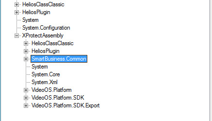

We have a tool to analyze dependencies
Direct link: http://download.milestonesys.com/mipsdk/mdepends.zip
Load your executable in this tool, it might reveal something amiss.

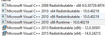

We have C++ redistributor installed.

I check with the tool and there are no missing binaries.

Sending you screenshots with my tests:
And installed c++ libraries:
In our case XProtect and Recording servers are on separated machines. Can this be the reason?
Do we have the correct C++ binaries installed?
