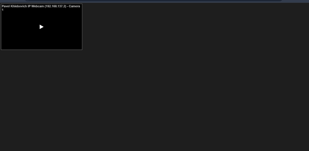

, a JavaScript web application. I managed to get the SDK running and opened the authentication page for the Milestone server. The authentication is successful using a basic user, and it shows that a camera is configured.

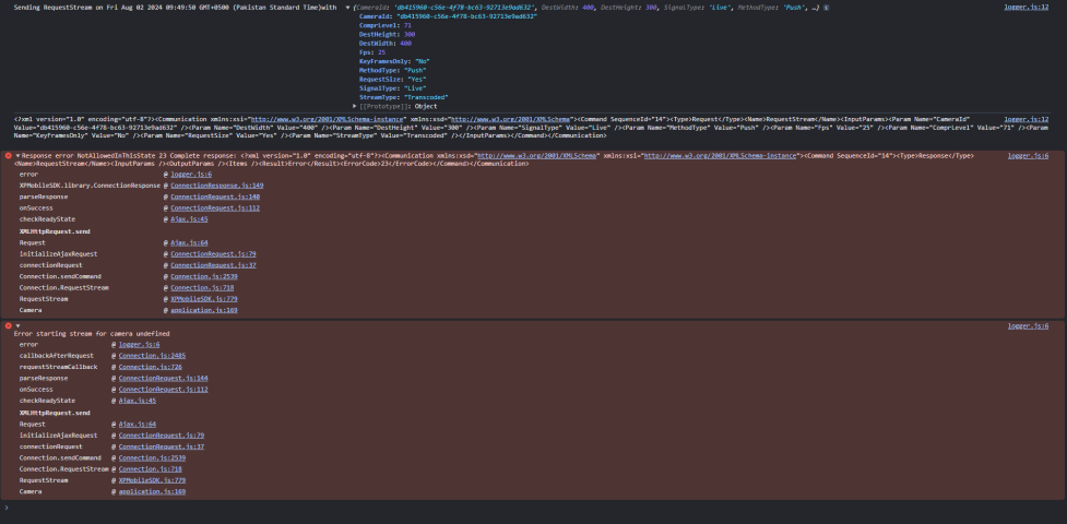

However, when I click the play button, the camera feed does not display on the webpage—nothing happens. I’ve verified that the camera feed is working correctly in the Management Client, so I’m unsure why it isn’t displaying on the web application.
I have attached the screenshots of the SDK webpage and its console window.
Could anyone provide guidance on what might be causing this issue or suggest steps to troubleshoot it?

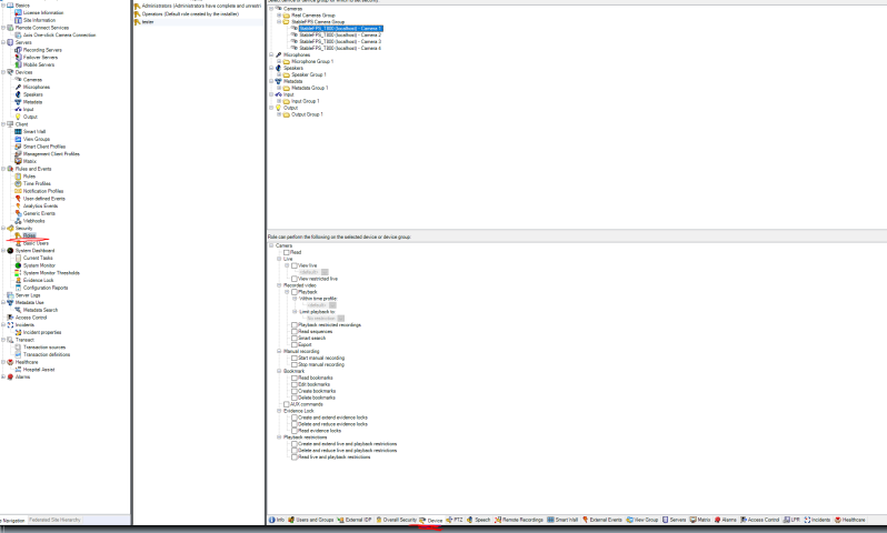

Hello!
my first idea what I would like you to verify is that you have setup the rights for that user correct,
if you open the management server could you make sure that your basic user is part of a role, and that role has adequate permissions to view cameras this can be specified on a specific camera or an entire camera group.
