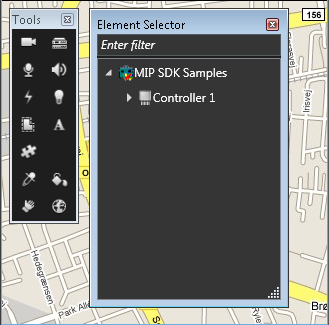

Installed the AccessControl plugin (from the SDK’s MIPPlugins directory) on both the management client and the event server. Setup controller and doors in the management client (like in the MIPSDK manual) and configured the security roles for the relevant roles. I am however unable to view this controller in the Smart Client. All I can see when pressing the “Add Plug-In Element” on the Alarm Manager’s Toolbox is “MIP SDK Samples”, but not the controller sub items like in the manual.

This is what my element selector looks like:

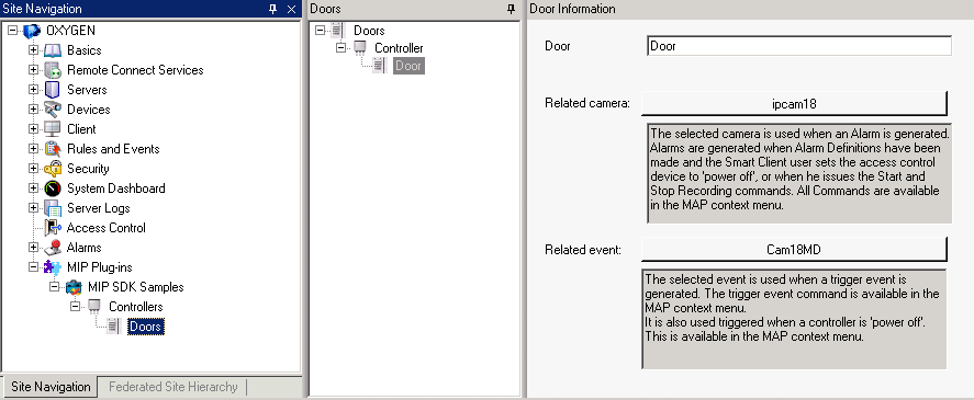

I believe I have a door setup in the managment client:

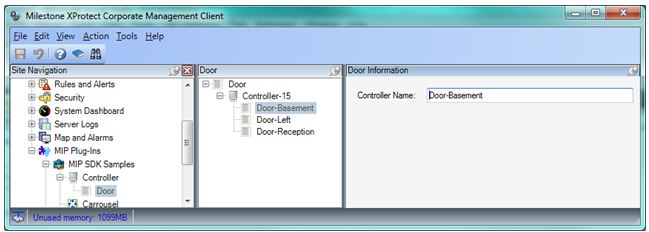

which is similar to the documentation:
Note that I get a slightly different “Door Information” page. Perhaps the documentation is a bit out of date?

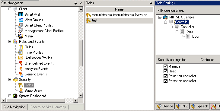

All children (including Door) of the controller have manage/read enabled:
So it was not that simple :slight_smile:
