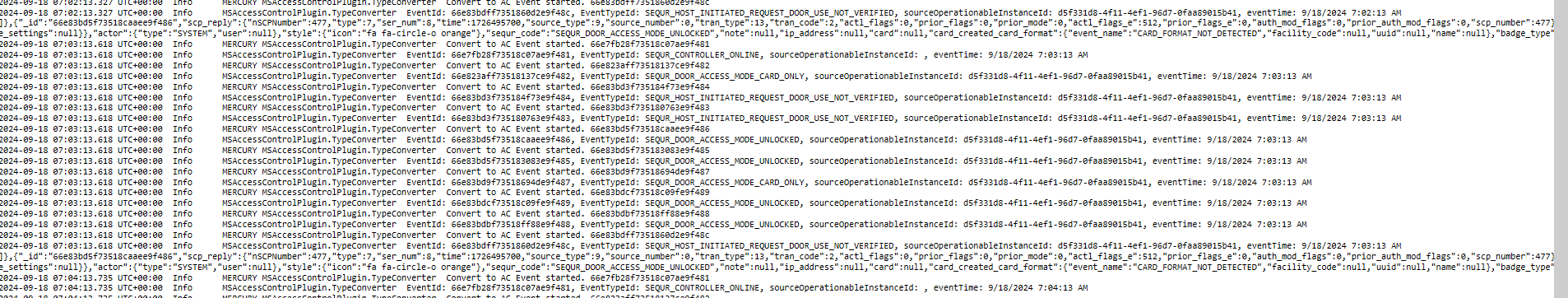

While the ToAcEvent gets called for processing the Events fetched from the API we can see in the logs that the events get converted to ACEvents successfully:

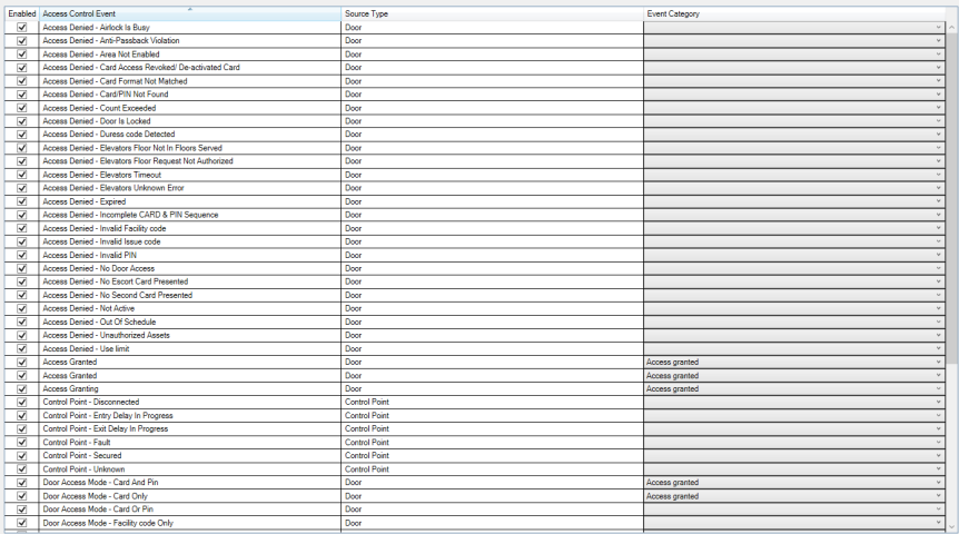

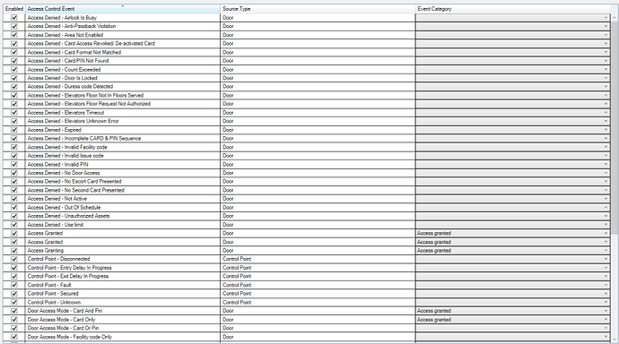

Also in the configuration all the events have been mapped to proper Event Categories:
