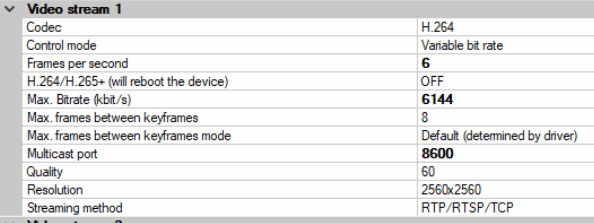

Please document in details how the camera is setup in XProtect. (Screen captures of the Setting and Streams tabs for the camera setup in Management Client could be a good way to include all.)

Hi Bo,
Here is the settings screenshot.
Thank you very much for your help
