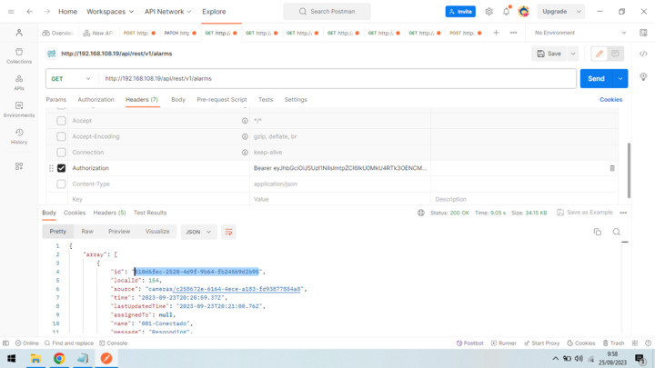

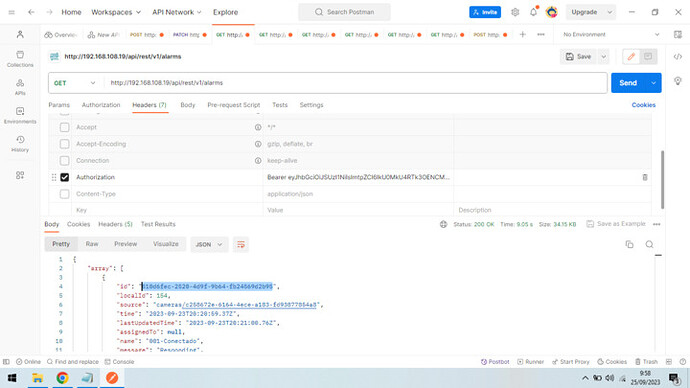

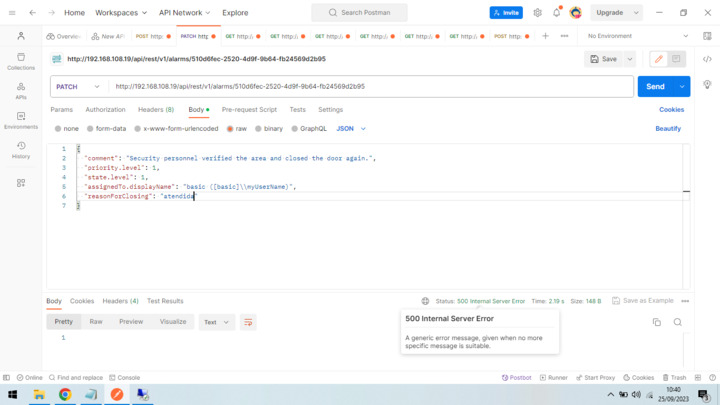

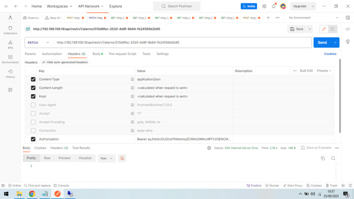

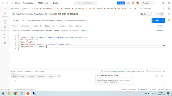

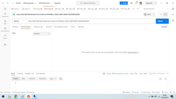

Yes, I’m using that URL. I show you with some screenshots.
I get the alarm list and I use the underlined id in the patch. The configuration is:BR,
