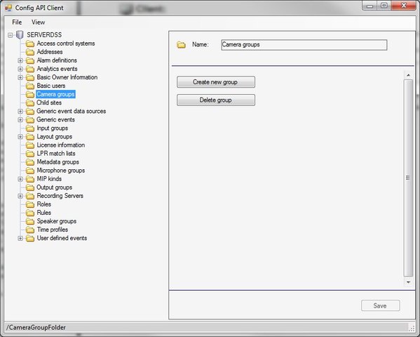

I’ve built and ran Config API Client sample and I see this screen:
In which folder exactly I can store my data? Or how I can create my own folder?

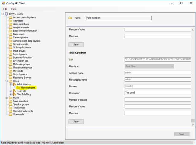

With your new remarks, I do not think what I wanted you to see fits. I wanted you to see the users, you will find those if you look under roles. See this..
This might be a step as you can find users, but you cannot store information for or about the users here.
