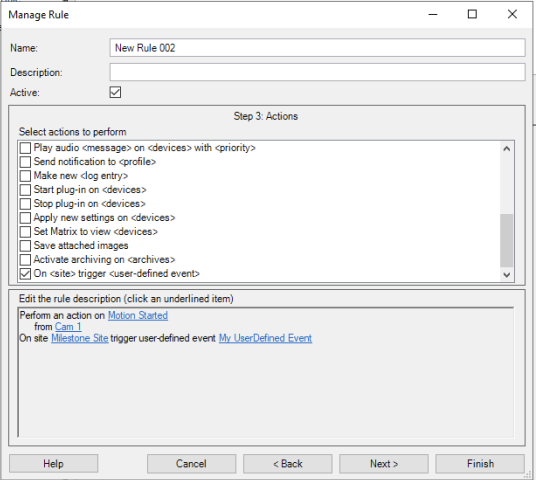

User-defined event, when triggered via a rule on other events occurring on cameras, does not contain any camera information
The user-defined event My UserDefined Event is being triggered fine, based on the rule I show in the screenshot.

The issue is that the “On trigger ” rule will have the wrong source for your purpose, I think you have described this accurately and correct.
One way to solve is might be to develop your own rule action. Please see Bat Action sample. This sample shows how a plug-in in the Event Server can work together with the XProtect rule system. Note how it can take the source of the camera that trigger it. You will need to change the sample code so that instead of executing a batch file it triggers a user defined event. (If reusing code make sure to replace the GUIDs.)
