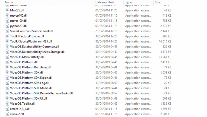

Hi Bo,
we have all the DLL’s in the folder.
see attached picture.
as i mentioned if i am running the app normally and not as a service all works fine.
it happens only when running as a service.
This screen capture does not show us that this is the current folder when your service needs the dlls. What I say is that I suspect that the current folder where the service looks for the dlls might have changed because you now have a service not a regular application.
