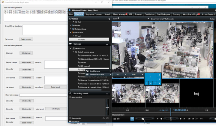

See how it looks for me:

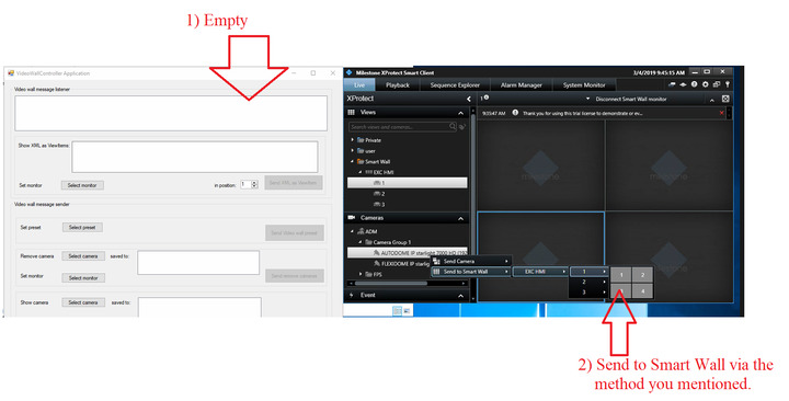

Hi, I have uploaded three screenshots with the following descriptions as followed:
  1. MessageListenerListBox is empty.
  2. Send camera to SmartWall using the method you mentioned previously.
  3. Camera is sent to SmartWall (or VideoWall?).

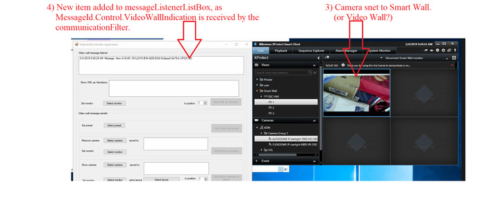

  4. New item is added into the MessageListenerListBox, as MessageId.Control.VideoWallIndication is received by the registered CommunicationFilter as in the MIPSDK VideoWallController Component Sample.

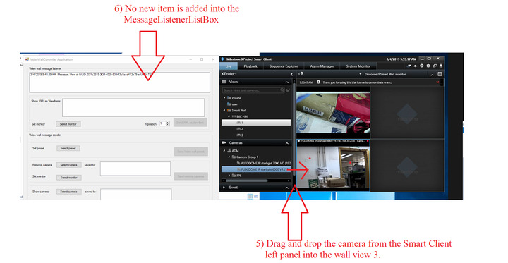

  5. Drag-and-drop another camera from the SmartClient left panel into the wall view 3.
  6. No new item is added into the MessageListenerBox. I suspect the MessageId.Control.VideoWallIndication is not invoked/sent by Event Server in this case?

When I in my setup do what you illustrate in the last image (action #5) nothing happens. The camera is not put on the view neither in the main window nor in an extra floating window showing the Smart Wall Monitor. I do not think it is supposed to work the way you are able to.

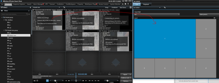

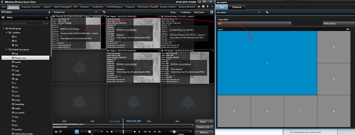

What you illustrate in action #5 does not update the Smart Wall. As an experiment make sure you have a second intsance of the Smart Client running displaying the Smart Wall monitor. When you do the update as action #5 to the current view, it stays there in the current view and current Smart Client, if you switch to the second instance of the Smart Client you will notice that it has not been updated.

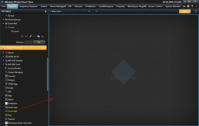

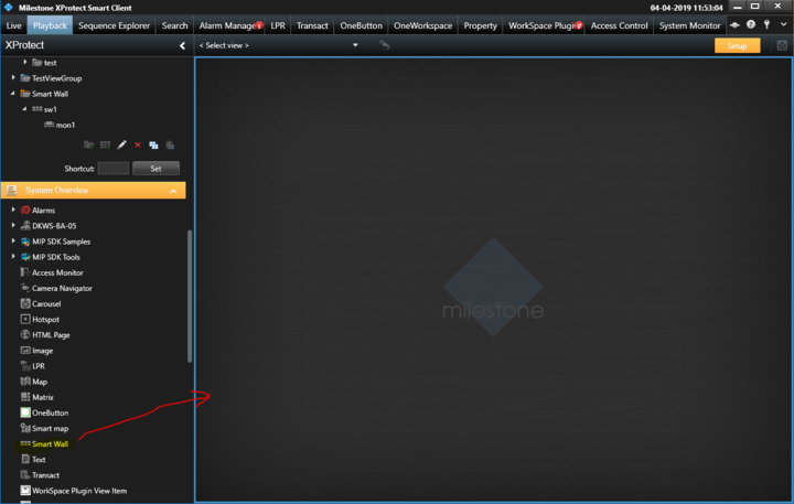

Tip: If you want to drag and drop change to the Smart Wall you can use the Smart Wall control:
When you have this you can drag and drop cameras form other views:
