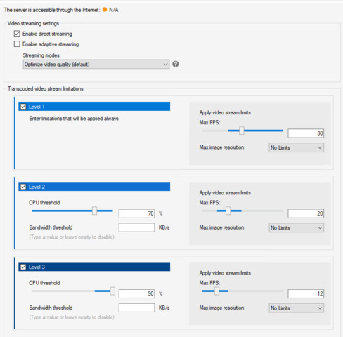

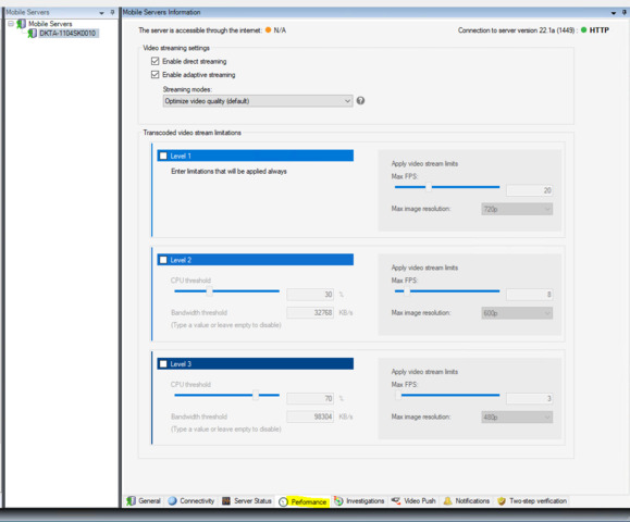

I assume, you might want to calibrate Mobile server performance in Management Client, see this -

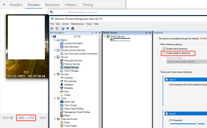

We have upgraded the Milestone system to version 2021R2, and disabled the feature adaptive streaming. But the image resolution is still very low. Please help to advise. Thanks.
If you see the same issue using the regular web client it is better to ask in the Support Community, you should get better help from the partners using the support community. https://supportcommunity.milestonesys.com
Why did you leave out the interesting part of the screen capture as we cannot see the rules that actually guide the Mobile Server to potentially use lower resolution. We would like to see MAX FPS and MAX image resolution on the right side of the pane.
I thought system will ignore the limitation setting after I disable the adaptive streaming.
Please read this explanation - Enabling adaptive streaming - XProtect Smart Client | Milestone Documentation 2021 R2 (milestonesys.com)
It says, “Adaptive streaming improves the decoding capability and performance of the computer running XProtect Smart Client. This is useful when you view multiple live video streams in the same view.” You are talking about web client, not Smart Client.
So you might want to configure Resolution and FPS and let’s see how it work.
