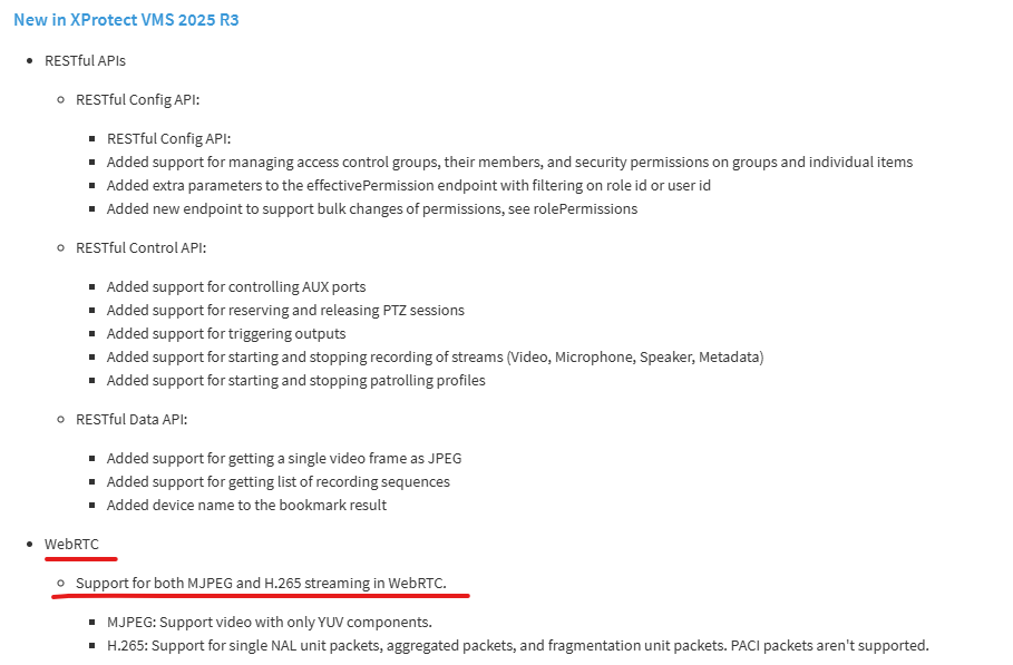

In Xprotect 2025R3 we have an integration with webrtc. It seems that we can have live video for both H264 and H265 protocols but unfortunately we have playback only for H264 protocol. We cannot have playback for H265 although live seems to work for this protocol. Is ther any limitation from Milestone’s side regarding playback on H265?

Apparently, it doesn’t support H265 protocol for plyback through webrtc although they have pulished that it does. Again, poor support from Milestone.
