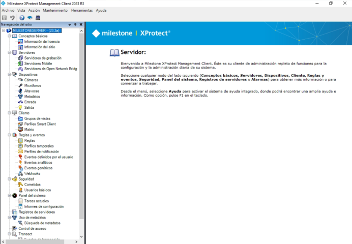

Actually, we have 2023R3 as it is shown in the following image.
Maybe it is available but not active? In that case, how should we activate it?
Try Tools->Registered services, see if you have it. (I am not sure the names in your language version.)
Maybe have a look at the “Quick Start” for the API Gateway - https://doc.developer.milestonesys.com/mipvmsapi/content/quickstart/
If you find that API Gateway is there and working but the sample isn’t working -https://doc.developer.milestonesys.com/html/index.html?base=samples/protocolsamples/webrtc_javascript/readme.html&tree=tree_3.html
I guess some observations on how it fails might be helpful.
