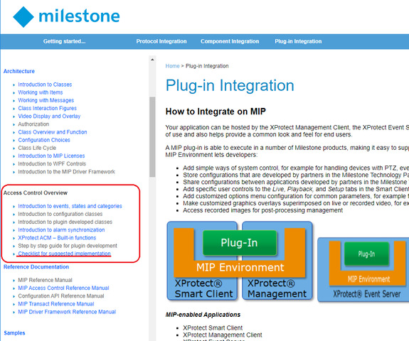

Please click this link -
https://doc.developer.milestonesys.com/html/index.html?base=content_1.html&tree=tree_1.html
And please read Access Control Overview. Especially, the last documentation describes what the minimum manager classes are needed.
