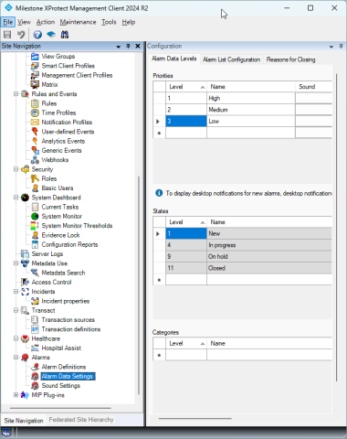

Please note that “PriorityId” does not exist (PriorityInt does).
An example of values can be seen in the Management Client.
