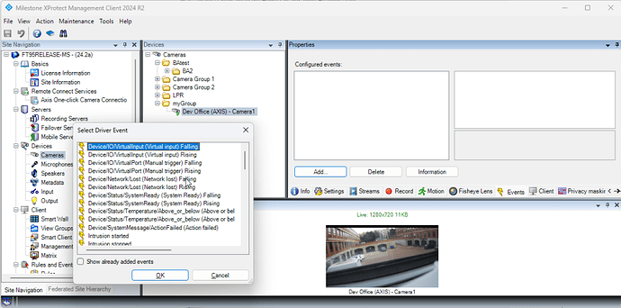

How does this work within the plug-in? I can set up an MQTT listener in the plug-in, but since Milestone can connect directly to the camera, I would like to know if there’s a simpler way to retrieve the event (Example: Crossline detection) metadata?

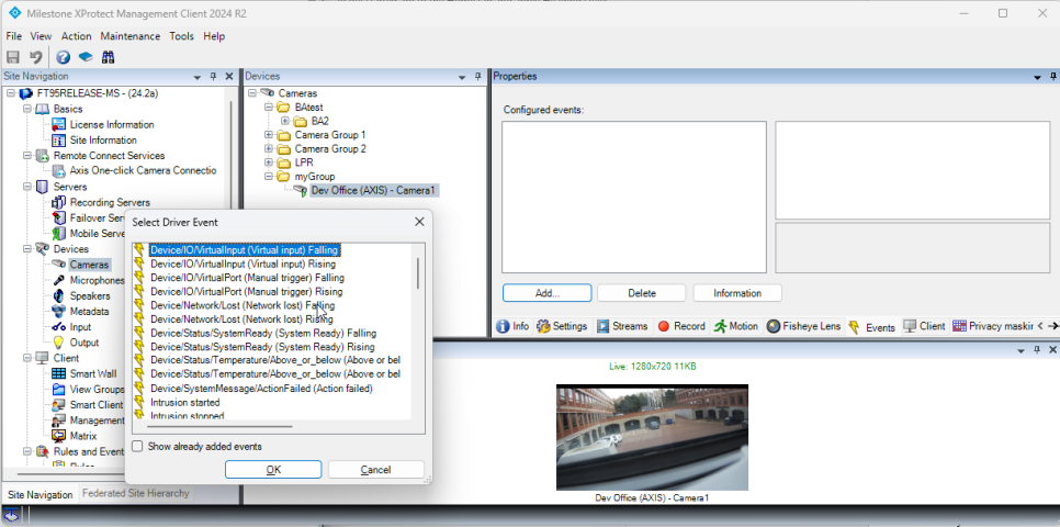

When you have camera events these can be added in the Management Client like this:
When the events happen they can be captured by listening for “NewEventsIndication”, they best way to see this in action is to explore the Alarm and Events Viewer sample (Events option).
