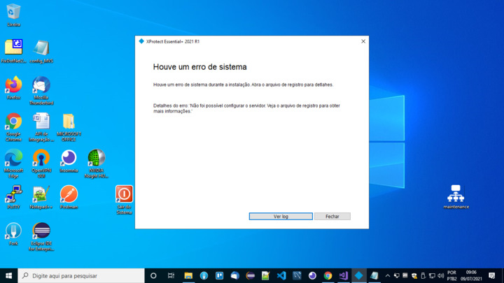

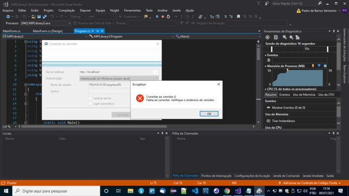

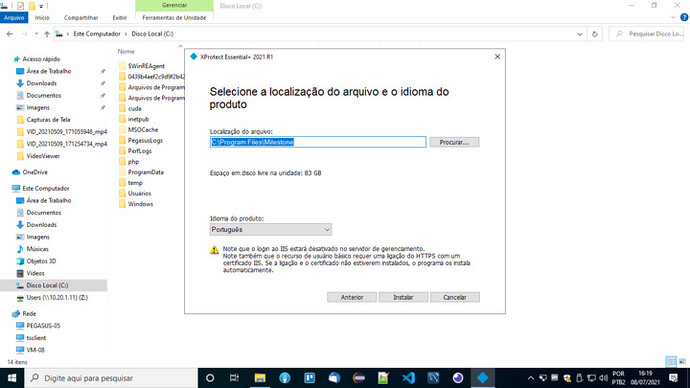

When I run a 'component' project, to login.There is this error "connect to server 0. Failed to connect. Check the server address." My xprotect version is 2021 R1. During installation this error occurred: "Unable to configure the server"

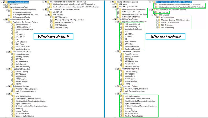

Is IIS required to install XProtect VMS?

Yes, you need to install IIS.

Considering only: When I run a ‘component’ project, to login.
There is this error “connect to server 0. Failed to connect. Check the server address.”
As for IIS, I’ve already installed everything. Using this image as a reference:
But, still getting the error:
