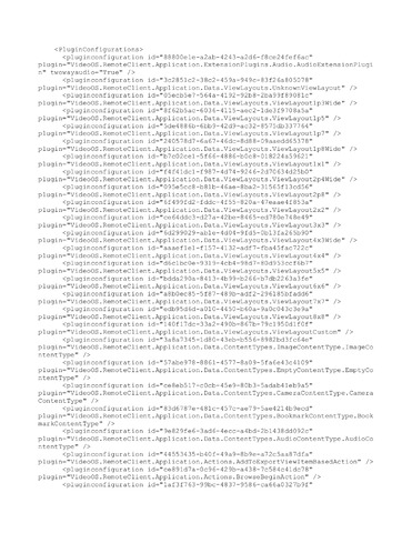

This will, however, only solve the problem for new exports. Already made exports will have to manually include the below list of PluginConfigurations in the SCP file. Unfortunately, already made reexports cannot be easily fixed, but can still be viewed in offline Smart Client by using the Open Database option in Setup mode.
The list of PluginConfigurations is too long to write in one reply space (because there is a length limitation), let me attach a file (PluginConfigurations.txt ).
posted a file.
