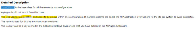

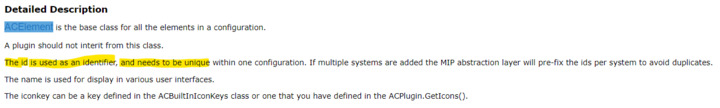

Since every element on an ACP configuration is an ACElement their IDs should always be different, regardless of the ACUnit.
As we can see on its documentation on this link and in this screenshot:
Besides, it is encouraged to use GUIDs as identifiers so a uniqueness identification is more likely to happen.
