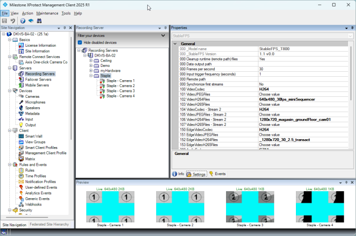

These instructions are on installing the driver and on adding the “device”, I think it lacks a configure section.
From READ_ME_StableFPS.pdf -
Configuring device
Note all configuration is done on “Hardware→Settings tab” node so you only need to change one place.
This is done so you don’t need to setup same settings if you are using multiple camera device.
Let me show you…
Thanks, after configuring codec values “Hardware→Settings tab” the stable added camera started streaming.
