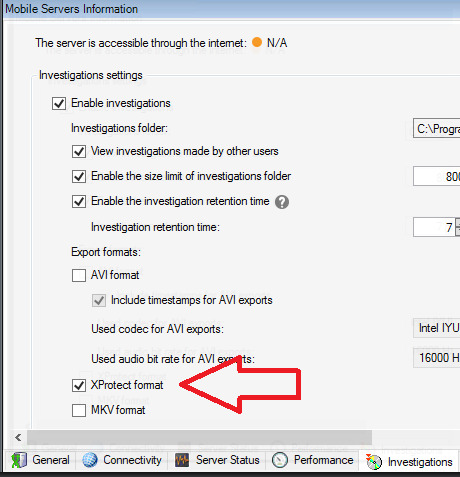

On calling StartInvestigationExport method, i got error as Not Allowed In this state 23.
There is no sample for this, unfortunately.
But your approach is totally in the right direction:
  1. CreateInvestigation
  2. GetInvestigation multiple times (e.g. every second) - until returned Status is “Saved”
  3. StartInvestigationExport
  4. GetExport multiple times (e.g. every second) - until State is “101” (meaning ready for download)
  5. CreateExportDownloadLink and use returned ExportLink to download
You’re getting error 23 because ‘XProtect export’ is disabled by admin. Please make sure to enable it, as shown:
