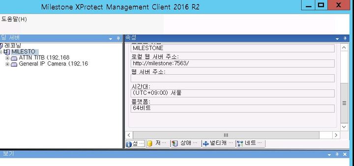

Why is guid not visible?
​hi sir
where is camera guid?
help

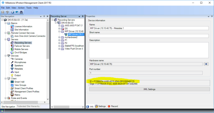

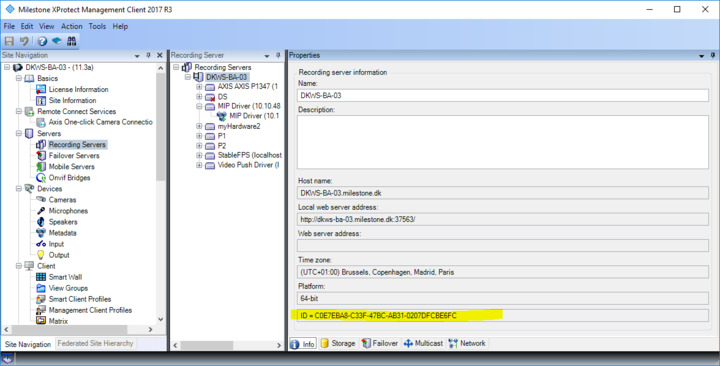

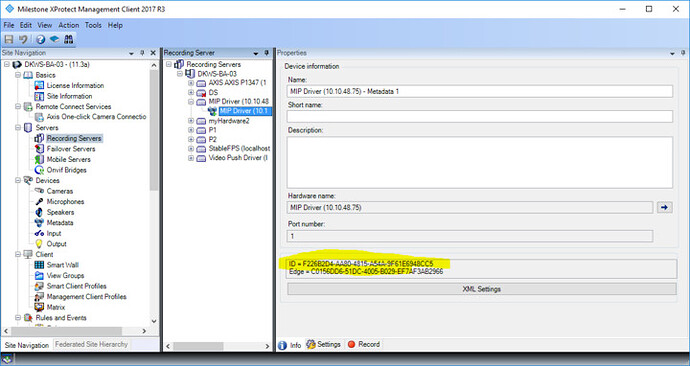

The Management Client can show you GUID for elements in the system, the secret to this is to hold down the CTRL button on the keybord when you switch to the Info tab.
Recording Server
MC2
Hardware device
Camera
