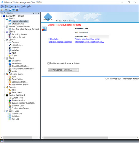

A few days ago, @Anna Varsamou (Milestone Systems)​ issued a test license for XProtect 2017 R2 Professional+.
So, I am trying to test my ACM plug-in on Professional+ but, there is not Access Control setting anywhere on Management Client.
​I think maybe It’s a kind of license problem. right?

What I can see now is a license issue. I suggest you use the license chat.. https://force.milestonesys.com/support/MccChatRoomOverview

Let me venture a willd guess. If you have a test license a few days old I would be surprised if it is XProtect 2017 R2 Professional+. I believe it is against policy to issue old versions for trial. My guess would be that you have a 2017 R3 license. If this is true you need to upgrade the software by downloading the new version. https://www.milestonesys.com/support/resources/download-software/?prod=1425&type=11⟨=27
I hope you get to license chat, they can easily decipher the version by the software license code (SLC).
