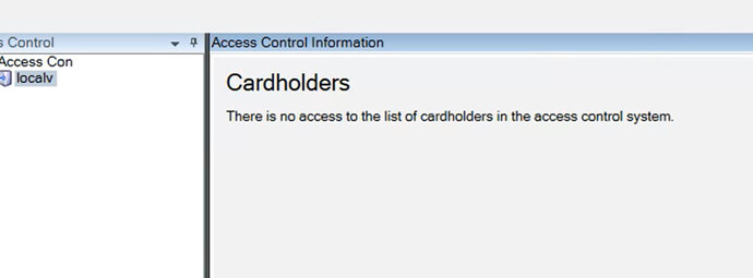

Why would the management client say no access to cardholders
I’m debugging my access control plugin and can see the milestone management client calling the function SearchCredentialHolders which is in this case returning at least one credential. But the tab says “there is no access to cardholders…” Any idea what to look for?
See attached screenshot.

By the way, its not clear what the possible roles should be here so I left it a blank string…could that be causing this problem?
Make sure that you set CredentialHolderSearchSupported property to true. You can see how the property should be set in DemoAccessControlPluign sample, CredentialHolderManager class.
FYI) There is a sample code “SearchCredentialHolders” method in CredentialHolderManager.cs in DemoAccessControlPlugin sample, please explore it regarding the roles.
Thank you.
i found it in the sample code. It was defaulting to true in the sample code, but the pre-generated class was defaulting to false. I didn’t realize the default changed. Its working now :slight_smile:
