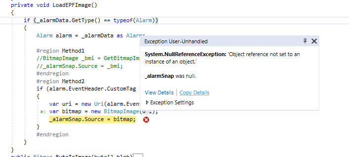

I am using WPF Image to load the alarm snapshot, but getting Object reference not set to an instance of an object Exception, whereas i can load image in normal WPF application.

i have used alarm preview sample to read the alarm line and loading image from the path available in the customtag
attached the code snippet.
Your LoadEPFImage() comes before InitializeComponent() .. That cannot work.
