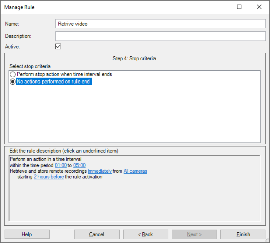

The way the automatic retrieval is made should work perfectly in most cases with no additional interaction from the user. If we make everything user configurable we will need huge UI an d it will add complexity for most of the users. I understand you case if very specific because the device is in moving vehicle. We had customer with similar problem. The devices were placed in public buses which were circulating all they and returning to the garage 1 a.m to 5 a.m. The solution was to retrieve the recordings automatically in that period when they had stable connection by making a Rule. That’s why I proposed similar solution for you. Make a rule for certain period of time or when connection is established with the device and no operator interaction will be needed.
