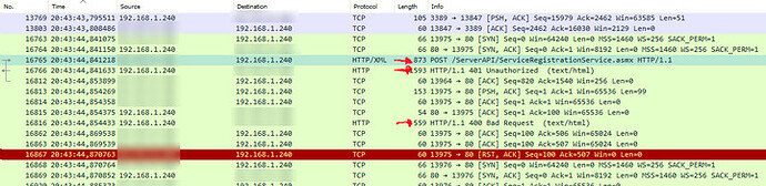

Remote access is enabled in the manager application/recording server, including the external port 44444. When I do a Wireshark trace on the Milestone server I see the following events:

Seems my wireshark screenshot is not there:
