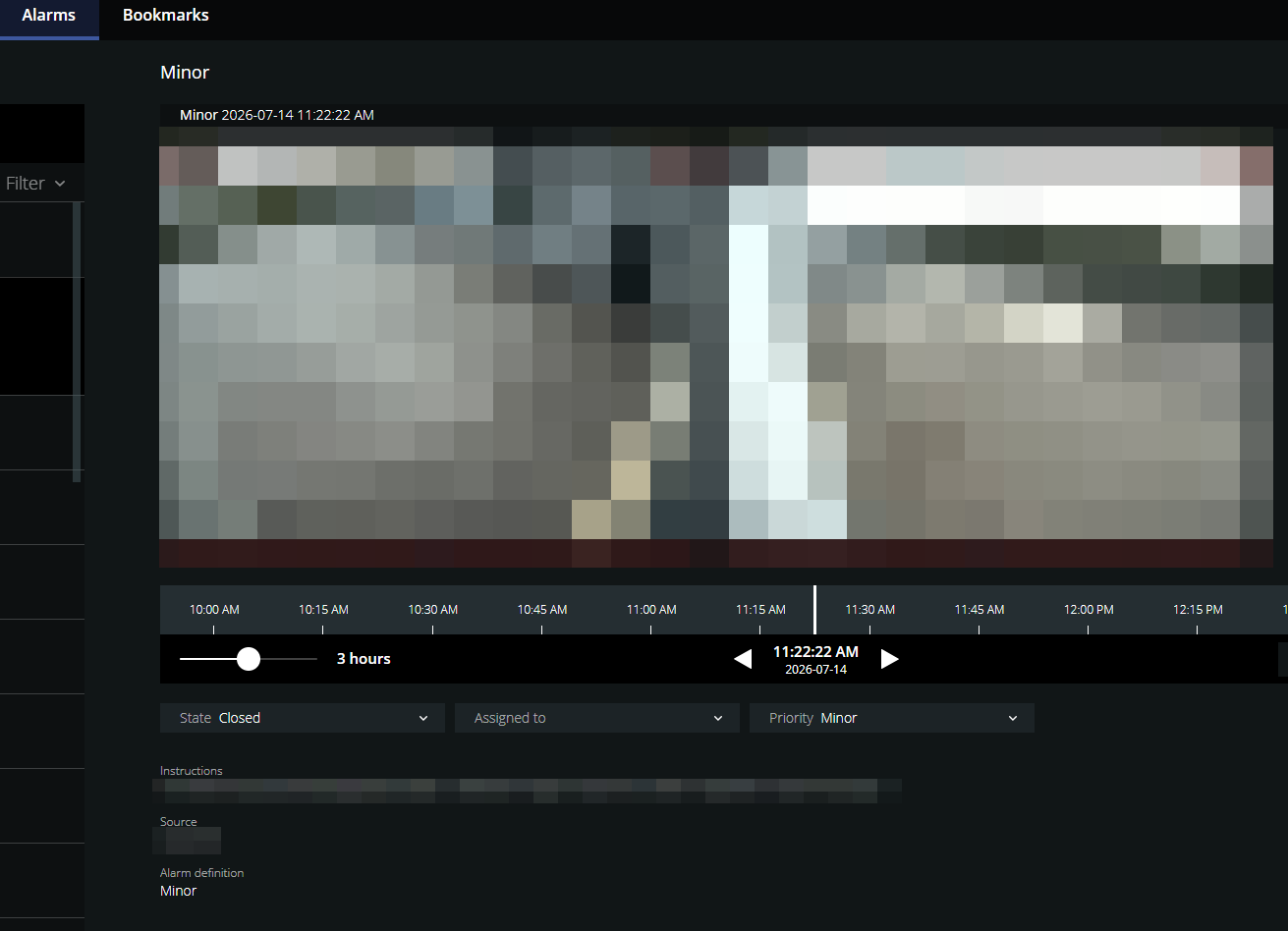

Alarm with 2 cameras, everything works fine:

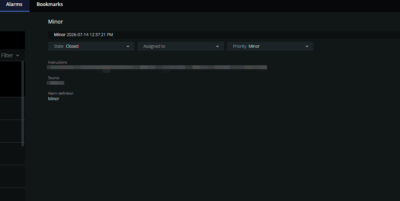

Single camera alarm, no video is showing:

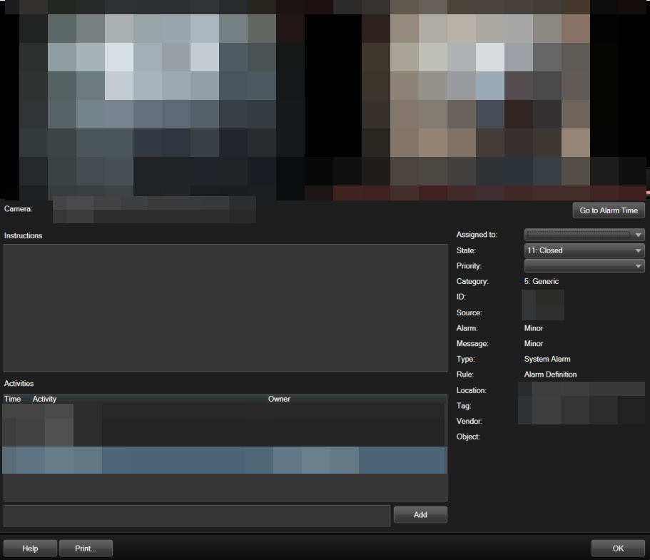

In the Desk Client it works:
Hi,
Thank you for the report. This is a known issue, and Milestone Development has fixed it. Please upgrade to 26.1 and apply the latest patches. (We ensure the best stability, we focus our patching efforts on 26.1 of the Mobile Server.)
Best regards, Rie
