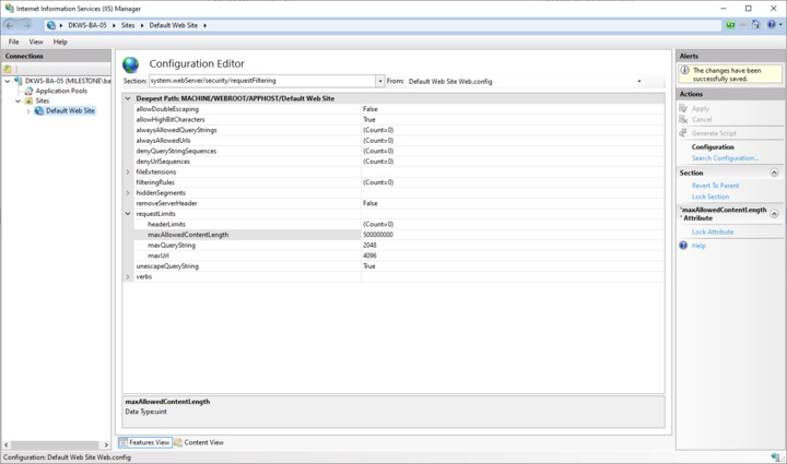

The problem is that the ConfigurationItem contains all children and everything is included in the request. This means that the request will be much larger than the default allowed request size in IIS and thus IIS refuses the request. This leads to the error we have seen if there are many Alarm Definitions on the site. We have found a workaround.
In the server hosting the Management Server service configure the IIS like this:
  • Open IIS Manager and pick the default website.
  • Start the Configuration Editor (in Management section of the window).
  • In the Section selector select system.webServer -security -requestFiltering
  • Expand the node “requestLimits”
  • Find the field “maxAllowedContentLength” and configure a higher value (I changed it from 30.000.000 to 500.000.000)
  • Restart Default Web Site
It is under consideration whether a design that does not include child items in this method and the big requests this leads to can be implemented. If this will be changed it is something that will come in future versions, for now please use the workaround.
