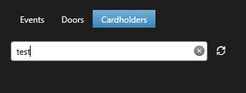

On the Milestone XProtect Smart Client when I navigate to the access control tab and try to search in the events search bar no input actually gets entered. However the search input when in the cardholders tab does work properly. My search credential holders function is based off the same function in the demo access control example. I also noticed that events without cardholders are no longer appearing in the events list (unless its set to live view). I’m wondering what the possible reasons could be that the events search bar doesn’t work but the cardholders one does as it seems that they both call the same function.
