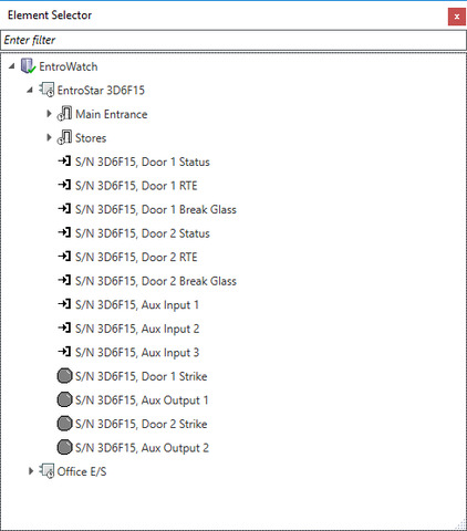

The problem appears to be at the Smart client - it no longer shows all the items that it did on the previous version
This is what it looked like on 2016 R3. on 2017 R3, I only see the Main entrance and stores beneath the top EntroStar unit and the access points beneath the doors
We suspect it might be an un-desired side-effect of a bug fix. (A fix that should hide diabled doors.)
We will be doing a closer investigation here at Milestone Systems.

  1. I can see that you have couple of inputs and outputs that are
related to some specific doors but are not underneath (children of) those. Why
is that the case?
  1. In case you need inputs/outputs that are not door related -
can you give us an example of that use case?
Hi Milos,
Our access control panel is a flexible unit that can have up to 2 doors/4 readers and then 9 inputs and 4 outputs.
By default, 3 inputs and 1 output are assigned to each door to cover the door contact, break glass and rte input functions plus the door strike and these are named according to the defaults. The remaining I/O is available for such functions as light control and intruder/perimeter detection equipment. Internally, within our EntroWatch product, we track the usage and condition of the inputs and update either the input itself or the door depending on its association.
In the case of the milestone plugin, for simplicity, we parent all the I/O against the controller, regardless of its usage.
