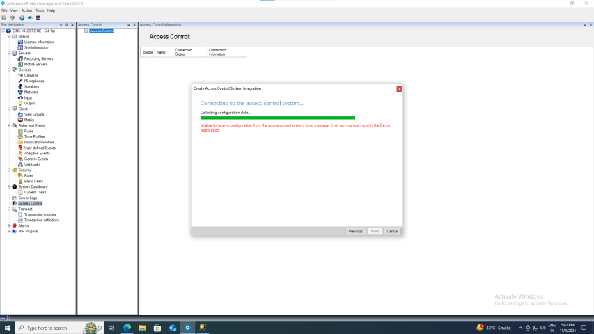

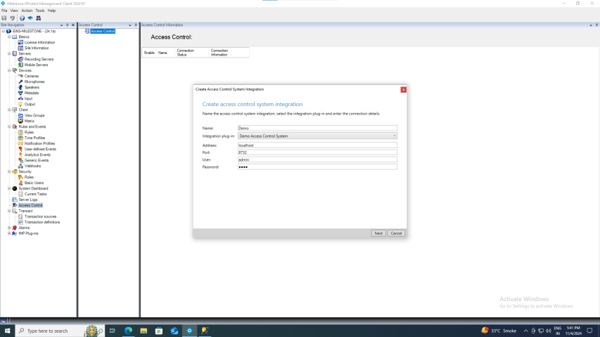

Hello Team,
When I m trying to create new Access Control Integration,after Entering the Name,UserID ,Password,It is unable to connect,getting follwing errors.
Attached the screenshot below for reference.
Hello Team,
My suspicion is that you are not running the Demo Access Control simulator in the server (localhost). There are some notes about running the sample in the documentation. If my suspicion is correct these notes should help you get it running.
Second step try to see if the Event Server logs holds a clue: “[C:\ProgramData\Milestone\XProtect](file:C:/ProgramData/Milestone/XProtect) Event Server\logs” and “[C:\ProgramData\Milestone\XProtect](file:C:/ProgramData/Milestone/XProtect) Event Server\logs\MIPLogs”
