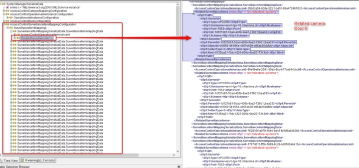

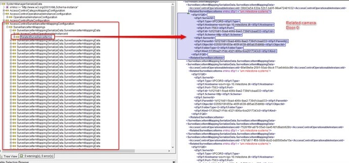

Then there’s a node which holds the relation between doors/AC_Units and cameras:
Namely, RelatedSurveillanceItems (Here’s the FQID of XPCO cameras)
MC uses this information to render & set doors and related cameras.
Hence, when raising an AC-Event we don’t provide the related the camera associated to a door/AC-unit, however, through a call to the AC Configuration API (as mentioned previously) you can retrieve at any moment the current binding/relation between any door and any camera (through its FQID).

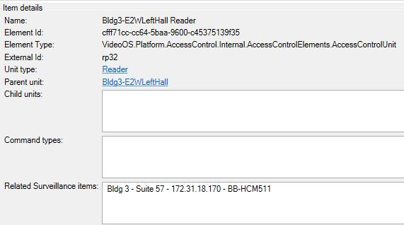

  2. In the XML that is retrieved (which looks like a copy of what is in the Central.ConfgiurationData SQL table), I can see the object ID of the camera in the RelatedItems section you highlighted. Unfortunately it does not list the ID of the door there, it lists an “OperationableInstanceId” instead. Further down the XML when it lists all the ACElements the Id there is the ID from the Access Control system. In the Management Client if you have developer options enabled you can find both:
    The Element ID is the “OperationableInstanceId” from the XML. The External ID is the ID from the Access Control system that is listed under the ACElements section of the XML.
Is there place you can lookup the correlation between these two IDs?

2 - You’re right, the doorId is not there :frowning: . I believe what MC is doing is looping that collection and based on the its index is setting Door 0 (in/out) 1,2,3,4 … since I don’t see any other place where that relation (door + camera) may be defined.
