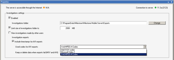

Hi Marian,
The additional codec should be installed on the Mobile Server’s machine.
I have tested with free available codes, like XviD (https://www.xvid.com/download/).
After codec installation Mobile server should be restarted.
Next is to refresh information shown in the Management Client (Mobile server settings) - click on different tab or different item and return to Investigations again.
And it should appear in the list:
