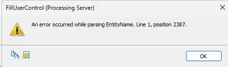

@ferguzman I’m not sure if I should have created a new post. but this may be related. I tried updating to 3.0.0 - and I’m getting this now on the front end UI when I click on the bridge. (processing server)

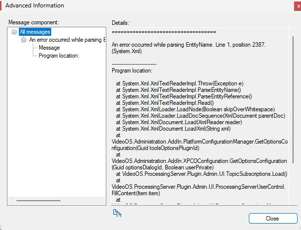

An error occurred while parsing EntityName. Line 1, position 2387. (System.Xml)
Program location:
at System.Xml.XmlTextReaderImpl.Throw(Exception e)
at System.Xml.XmlTextReaderImpl.ParseEntityName()
at System.Xml.XmlTextReaderImpl.ParseEntityReference()
at System.Xml.XmlTextReaderImpl.Read()
at System.Xml.XmlLoader.LoadNode(Boolean skipOverWhitespace)
at System.Xml.XmlLoader.LoadDocSequence(XmlDocument parentDoc)
at System.Xml.XmlDocument.Load(XmlReader reader)
at System.Xml.XmlDocument.LoadXml(String xml)
at VideoOS.Administration.AddIn.PlatformConfigurationManager.GetOptionsConfiguration(Guid toolsOptionsPluginId)
at VideoOS.Administration.AddIn.XPCOConfiguration.GetOptionsConfiguration(Guid optionsDialogId, Boolean userPrivate)
at VideoOS.ProcessingServer.Plugin.Admin.UI.TopicSubscriptions.Load()
at VideoOS.ProcessingServer.Plugin.Admin.UI.ProcessingServerUserControl.FillContent(Item item)
at VideoOS.ProcessingServer.Plugin.Admin.UI.ProcessingServerItemManager.FillUserControl(Item item)
at VideoOS.Administration.AddIn.UserControlPlatformInfo.InitCheckAndFillUserControl(Item item)

@Vince I’d say the topics subscription database entries got corrupted, you will not find any problems on the Recording Server nor AI Bridge backend, now the problem is on the topics subscription data, still is not related to your original post, metadata devices and Recording Server restart loops.
I would suggest to start over again with the AI Bridge topics subscription and the metadata devices creation bu first, let’s try to dig a bit more on this particular problem.

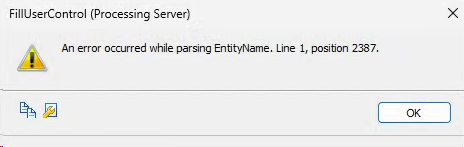

@ferguzman - So I’ve deleted everything associated with the processing server plugin, I made sure there are no other clients that are running Management client with the processing server plugin. And I’m still getting the same error. At this point I’ve have removed all metadata devices. I even tried rolling back to 2.0.5, still the same error.
I need to fix this. I can’t imagine even if I used the wrong processing server version, it would not break this hard. Please any help would be appreciated.

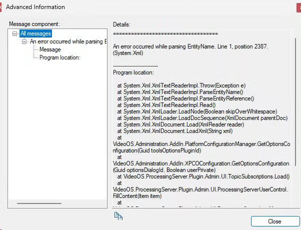

Program location:

I was able to dig into the stack trace that led me to this file ID 8c2ce0e4-d755-4171-95e1-1154a67f83d1
I found what I believe is the same database line in preprod as in the production. I was able to remove it in the testing environment, with no negative consequences to the system. It was regenerated automatically when I subscribed to new metadata topic.

Just completing this post, showing the fix to the issue in case anyone else runs into this problem.
Indeed the error shown earlier in this post can be fixed my removing the corrupted configuration for subscriptions for processor plugin in the database file. After removing the IDCustomSetting 8c2ce0e4-d755-4171-95e1-1154a67f83d1 from the database the configuration issue went away, this was in connection to the error TopicSubscriptions.Load().
