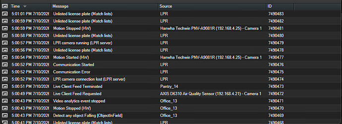

I am using AI bridge to send events from our IVA application to milestone. I have several setups of this already in other devices and it works fine but on this setup it does not work
Below are the logs from our IVA app as you can see the content is consumed as expected but

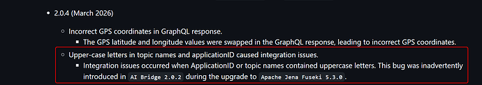

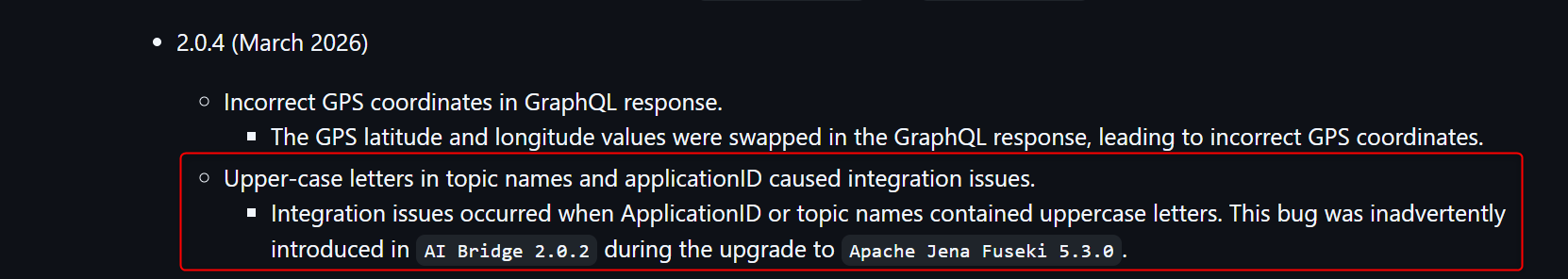

PS: In version 2.0.2 we added a regression affecting capital letters on applicationIDs and topicNames.
We patch it on 2.0.4
Just sharing here in case you are using one of the affected AI Bridge versions (2.0.2 and 2.0.3)

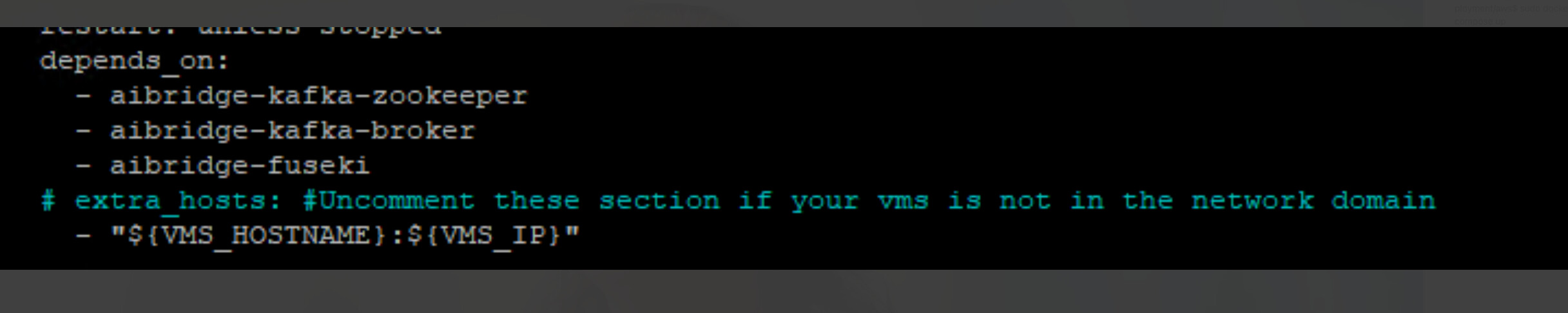

I have un commented the two extra hosts lines in docker compose
Attqached is the env file
Env_file.txt (1.3 KB)
mic-733ao@ubuntu:/opt/aibridge_3_0_0/aibridge_compose_deployment/aws$ sudo docker compose down
service “aibridge-streaming” depends on undefined service “XProtect.mls.com:192.168.4.103”: invalid compose project
mic-733ao@ubuntu:/opt/aibridge_3_0_0/aibridge_compose_deployment/aws$ sudo docker compose up
service “aibridge-connector” depends on undefined service “XProtect.mls.com:192.168.4.103”: invalid compose project
For some reason it fails

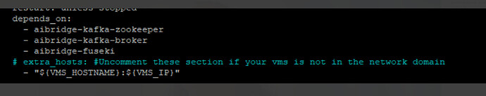

Hi @milestone_sharath ,
I noticed in your picture above that the line ‘extra_hosts’ is still commented.
The block should look like:
    extra_hosts: #Uncomment these section if your vms is not in the network domain
     - "${VMS_HOSTNAME}:${VMS_IP}"
