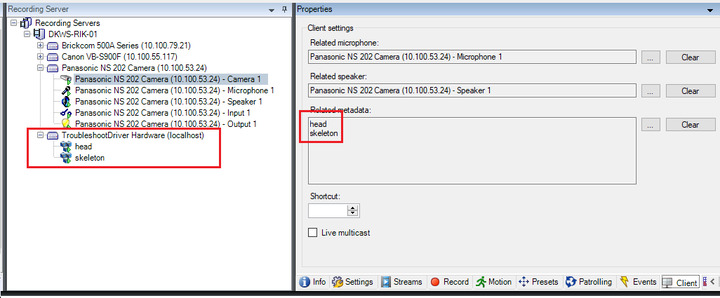

When I’m using the alarm manager, and one of my cameras which have 2 metadata devices from my MIPDriverFramework developed driver, the whole UI freeze almost every time the manager loads. Note that the metadata does NOT store onvif-compliant XML data, it’s 100% custom text.

If it’s relevant, the custom metadata DFW channels contain 3 MetadataTypeDefinitions, 1 native, MetadataType.BoundingBoxTypeId, and two custom ones.
Please give us the raw data of the metadata for us to experiment and try to reproduce. Perhaps even better you could give us a small project that sends the metadata you have, to make it easy and make sure we can reproduce the exact issue.
Here’s a project with a driver that causes this issue. This is just one metadata channel, the issue occurs more frequent on the ‘real’ project which contains more channels. I added a video where I demonstrate the issue in the root folder.
